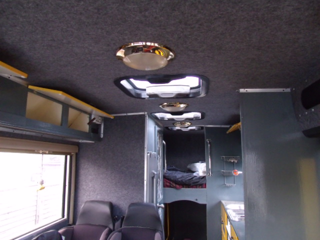

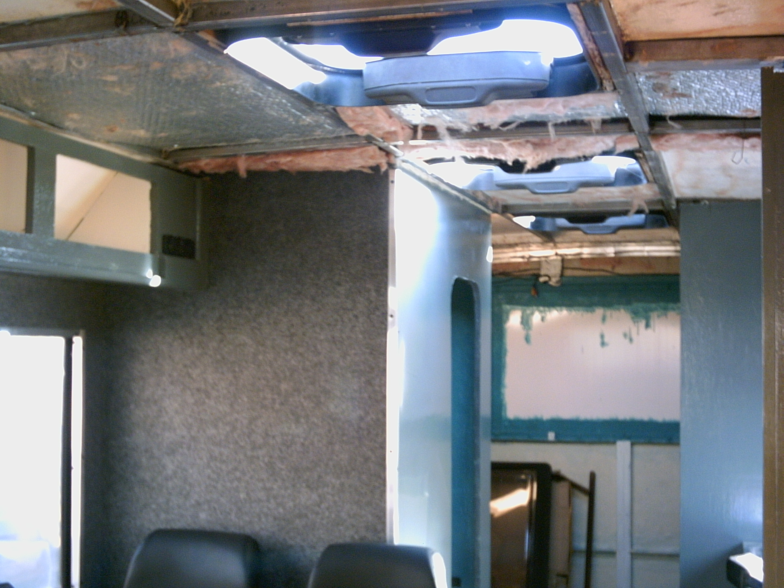

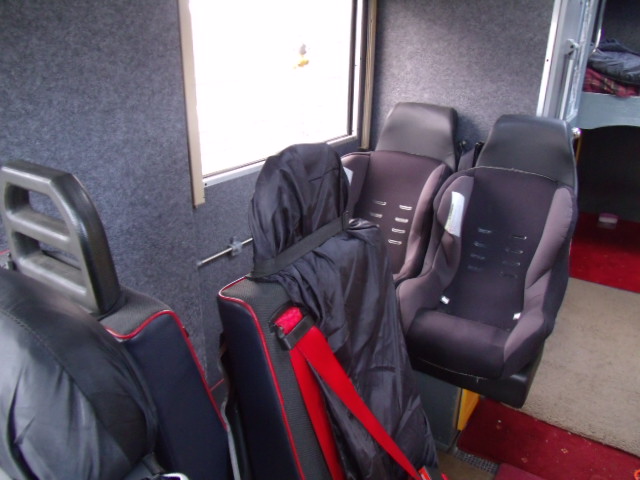

My van was set with thin ply over insulation and riveted to the steel box frame which the outside alloy panels are fixed to, i used wide head rivets then covered the panels with trim cloth.
