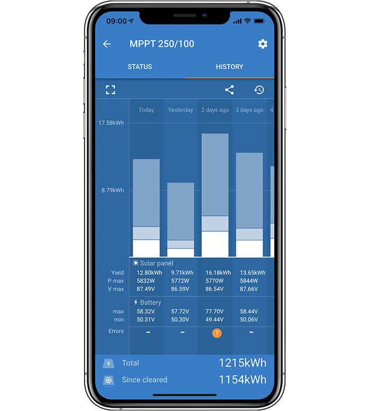

I have a friend who is going to fit solar and I would like some clarification on which Victron controller he needs. Total of 600w solar which is made up of 4 of these https://www.alpha-batteries.co.uk/12v-150w-xplorer-solar-panel-for-caravans-boats-motorhomes/
Using the calculator on the Victron website it comes up with this for Bluetooth with terminals. Is this correct? I am never sure what Victron stuff is with the way they label which is one reason I didn’t use them but he already has Victron mains charger and BMV so it makes sense to stay with the same brand.
SmartSolar MPPT 150/45 up to 250/100
