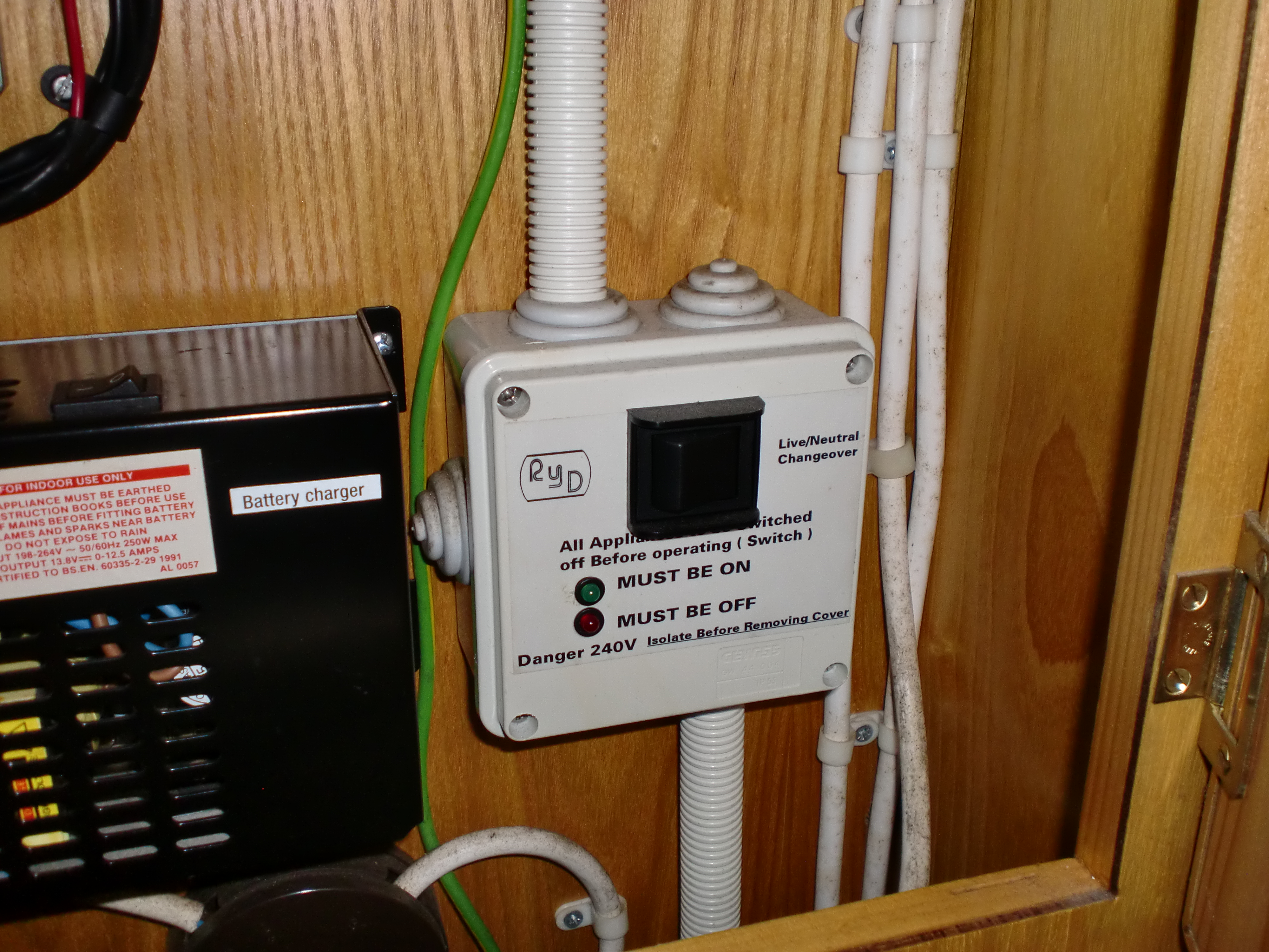

I didn't think they still made the RYD changeover switch Trev. Mine has been fitted 27 years, useful
in Euroland and beyond, due to 2 pole live hazard when used with single pole UK equipment.
Especially when they looked like the deluxe model below !
