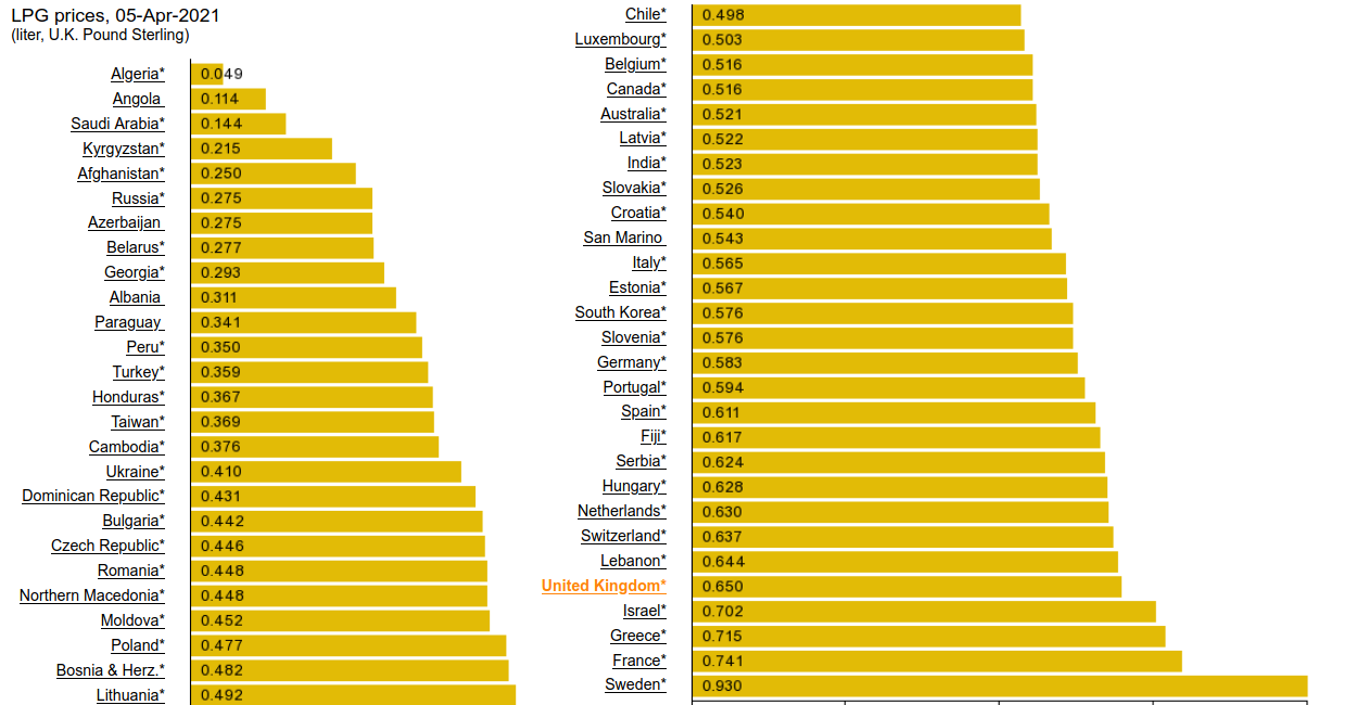

Big No for pre filled bottles rip off. But if you would have refillable bottle as of today 0.65p per liter.
58p per litre at my local stop...

Just come back and filled up ready for next weekend 54p at my local bulk supper Cardiff gas in Barry. Phil
That's for the public off the street I buy £100 a time so my LPG is reduced to 51p I think, it has two pumps one in the yard and one outside to which those of us that prepay have a key. 24 hrs 😉
