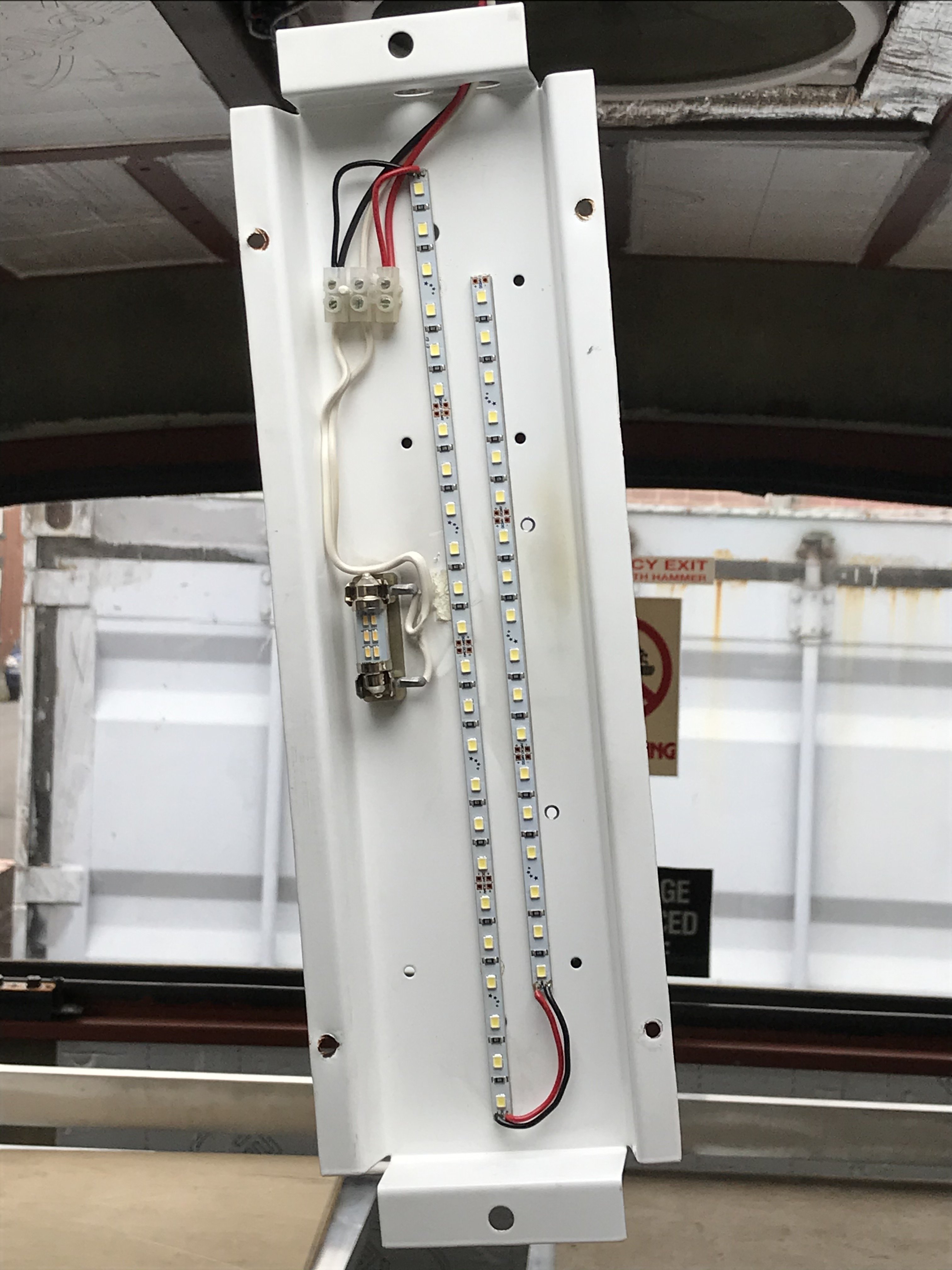

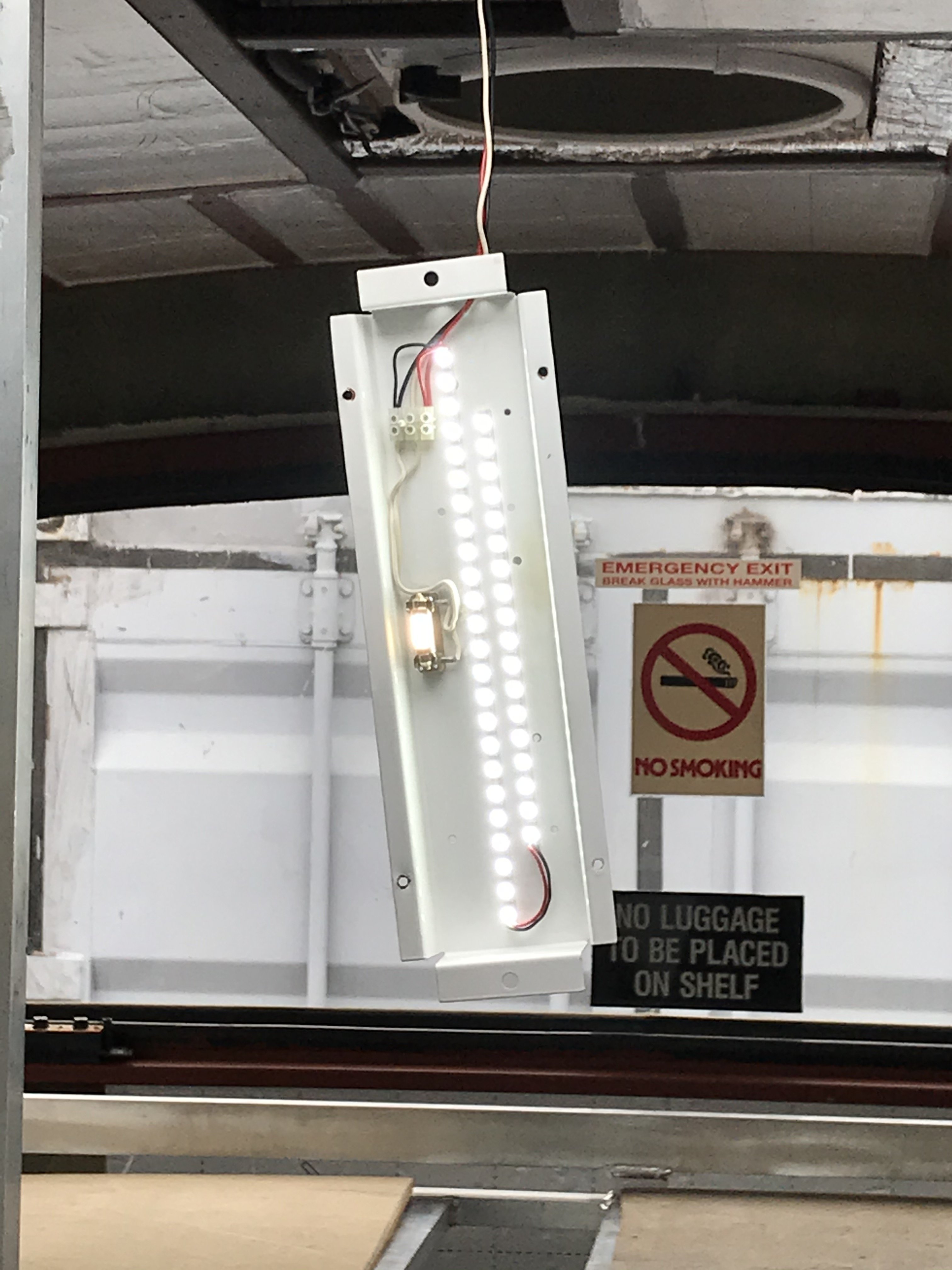

A very simple job if you are still running fluorescent tubes. Clean the housing of all the electrics and replace with sticky back LED strips.
These lamps only had one tube and a festoon bulb so the savings on power were not wonderful, about 2 watts.
I've done it before on older twin tube ones and the saving was much better.
Despite the small saving, the light is much brighter.
View attachment 2766View attachment 2767

Got a couple similar Trev but either 72 or 74 leds, very bright. One on each sofa for if Caz is doing craft stuff or we need bright light. Think mine were around a tenner each
in terms of brightness, most modern LEDs are now dimmable without any flicker, which is very handy.
