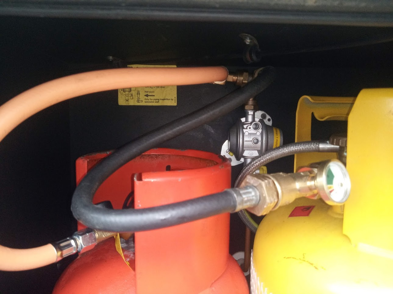

Not a gas person, but I did what you are talking about the other way - and same difference I think?
I had 2 Calor Bottles (just one connected at a time) and installed a Gaslow setup, removing the big Calor and keeping the small 6Kg Calor as a backup.
I fitted the dual connection piping which will allow me to turn on either bottle from the bottle 'knob' so can use either.

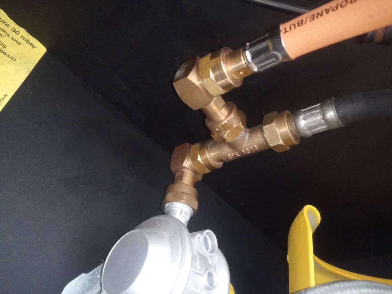

A wider angle shot ....
I haven't had it checked out physically by a gas chappy, but have send the photos via Neil to Charlie of Autogas 2000 and he said it all looks ok.
It all seems to work as it should when I tried swapping supplies.
Thank you. That's simpler than I thought! I'll look at fittings and our installation, which looks similar.
If you have a twin bottle system just remove one bottle and pipe and add a pigtail and Calor (or other) bottle 👍
