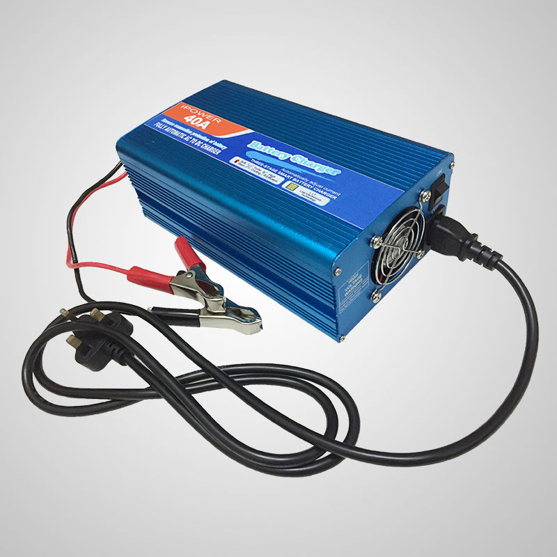

Or you could buy one from ebay for 20 bucks as i did.
smdts

those 40a chargers on ebay are £88 now, unless i am missing a trick?
also anything that comes with those fuseless plugs I dont feel comfortable leaving powered up unsupervised, If they are pennypinching on a fused plug, what other nasties are going on inside the casing, what is the primary-secondary isolation like, when I worked in a power supply design lab as a tech we reverse engineered a lot of chinese power supplies that faked our branding but had deathtraps inside, to the point where the failure of a single already underspecced swmiconductor would result in 240v at the 24v output terminals.
Mine has a fuse and works 100%,i do see a price rise on some,i was lucky at 20 bucks,yes there is crap out there but stuff in shops here is crap to these days,prob all from china but cannot blame every thing made there.
