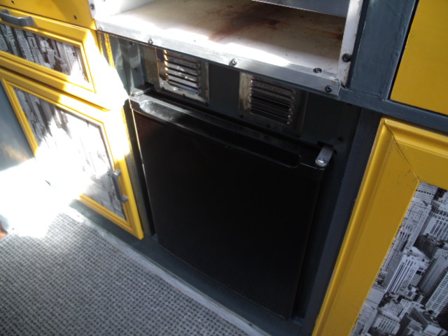

I put one that I bought off Amazon into my Daughters build, the exhaust I made up from diesel heater exhaust and fitted dometic fridge vents and it's working beautifully. These cheap Chinese fridges have the same exhaust as the more well known big brands but are a lot lower down due to the physical size of the fridge, so you either elevate the fridge or lengthen the exhaust as I did. Phil, simples.
P.s.
So long as the fridge is in a sealed off compartment with an exhaust that emits to the atmosphere, with vents top and bottom of the compartment there should be no danger of monoxide fumes entering the living space. If the flame is burning correctly there should not be any monoxide in any case, but correctly fitting the fridge and exhaust would prevent any monoxide from entering.
I fitted one from Ebay in my sister in laws van and that was 3 years ago, it's still doing sterling work and without fault.
