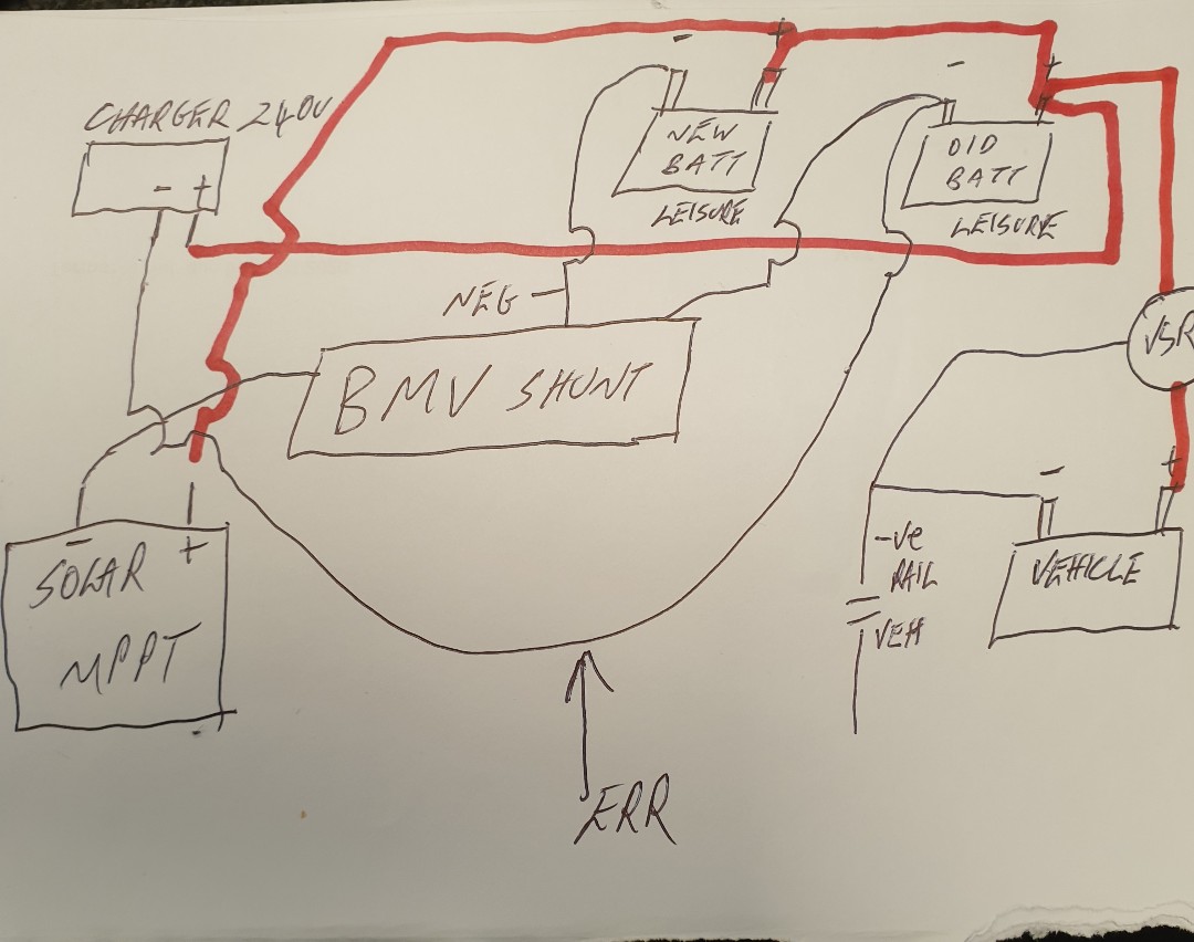

Here's a shoddy (NOT BIG CLIVE) drawing of how I think the wiring is (at work at the minute), which would explain why the BMV isn't recording the Charge from the 240V Labcraft charger.
I can't remember how the BMV is but pretty sure only the 160AH Alpha is on the battery side and everything else is on the other side but will check later tonight. Thanks @wildebus
I don't expect it's only me, but it hard to get your head around the idea of a load being on the negative side of the battery. I just keep reminding myself that everything must go through the shunt to be recorded.
Ref your diagram ...
Thinking on how you have said the batteries are located, are you sure about the -ve connection on the old battery?
Excluding the Charger (which you have identified as needing moving), is the only connection to -ve on the old battery the one going to the shunt? There are no 'historical' connections still there?
If there were you would need to connect those to chassis ground so they are on the correct side of the shunt as far as current detection goes.
If you are connecting both (old and new) leisure batteries to the BAT side of the Shunt, then you must remember (you may well have done this, but commenting just in case and for others doing something similar) when setting up the Battery Monitor to set the capacity at the C20 rating of the TOTAL Ah of BOTH Batteries, not just the new one. If you were to only set it at the new one, your SOC reading would be pessimistic and it would tell you the battery BANK state of charge was lower than it really was as it is calculating for a single battery not a pair. (the Current readings are still correct, it is just the SOC maths that goes out of kilter).
Alternatively - and this may be a better option as I think you said you often disconnect the old battery (IIRC?), move the -ve cable from the old battery from the BAT side of the shunt to the LOAD side of the shunt and set the BMV Ah to just the new batteries C20 capacity. This will (if you do disconnect the old battery often) give a better picture for you as the BMV won't suddenly have 50Ah or whatever it is of apparent capacity coming and going and confusing the SOC indication.
This would treat the old battery as a "reverse load" (i.e. a load that is providing power). There is nothing wrong with this and it is no different to the starter battery that will appear just like that whenever the VSR is energised.
end of the day, the BMV is just a monitor and doesn't actually affect how the batteries work, but if the SOC maths is getting confused, you won't be able to rely on the info to see what is going on.

As far as I am aware the negative on the Old Leisure battery is connected to the chassis plus has some other cables running from it
I have connected the negative load of shunt to the Old Leisure battery negative
I have connected Positive From new Leisure Battery to Positive on old leisure battery with an on/off switch in between
So I would need to do some serious rewiring I think to make the whole system and BMV monitor work as it should from what you have said above @wildebus, not sure I CBA TBH !!
When the switch is open on positive then the BMV is giving false information maybe on the SOC of the Alpha
if you have the negative on the old battery going to chassis AND going to the battery side of the Shunt, then the BMV is not going to be reading current loads remotely accurately.
As a "quick fix" move the old battery cable from the BAT side to the LOAD side and then at least the currents being read will have some meaning.

I am fairly sure the Only cable to battery on Shunt is from -ve on New Battery, will double check later though, thanks
Here's the Shunt
It's all a bit of a mess at the moment as not sure where I am placing components etc for final fix
The only cable on the 50MV part is -ve from the Leoch Alpha Battery (new)
