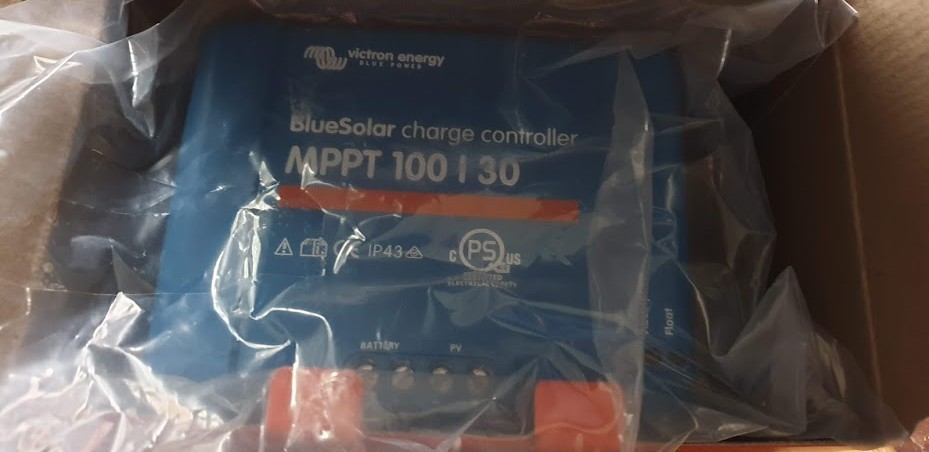

The Victron Controller is a Bluesolar 30/100 Datasheet is here
Can't see if it would be compatible with this though ?
https://www.ebay.co.uk/itm/Victron-...-meters-for-MPPT-Solar-Chargers-/302679865369
Any ideas ?
Cheers
Hi,
Nope, it would need to be the SmartSolar rather than the BlueSolar to work with the Smart Battery Sense. (it has to talk to the built-in Bluetooth module and so would not interface with the Bluetooth dongle that is available either (at least not with the current firmware))

Thanks for the clarification, I am not at home but had a look at the bad photo I took of the Victron
So as you say it is a Blue Solar and having done a bit more research then it seems like, again as you say, that there is no Bluetooth. Bummer.
