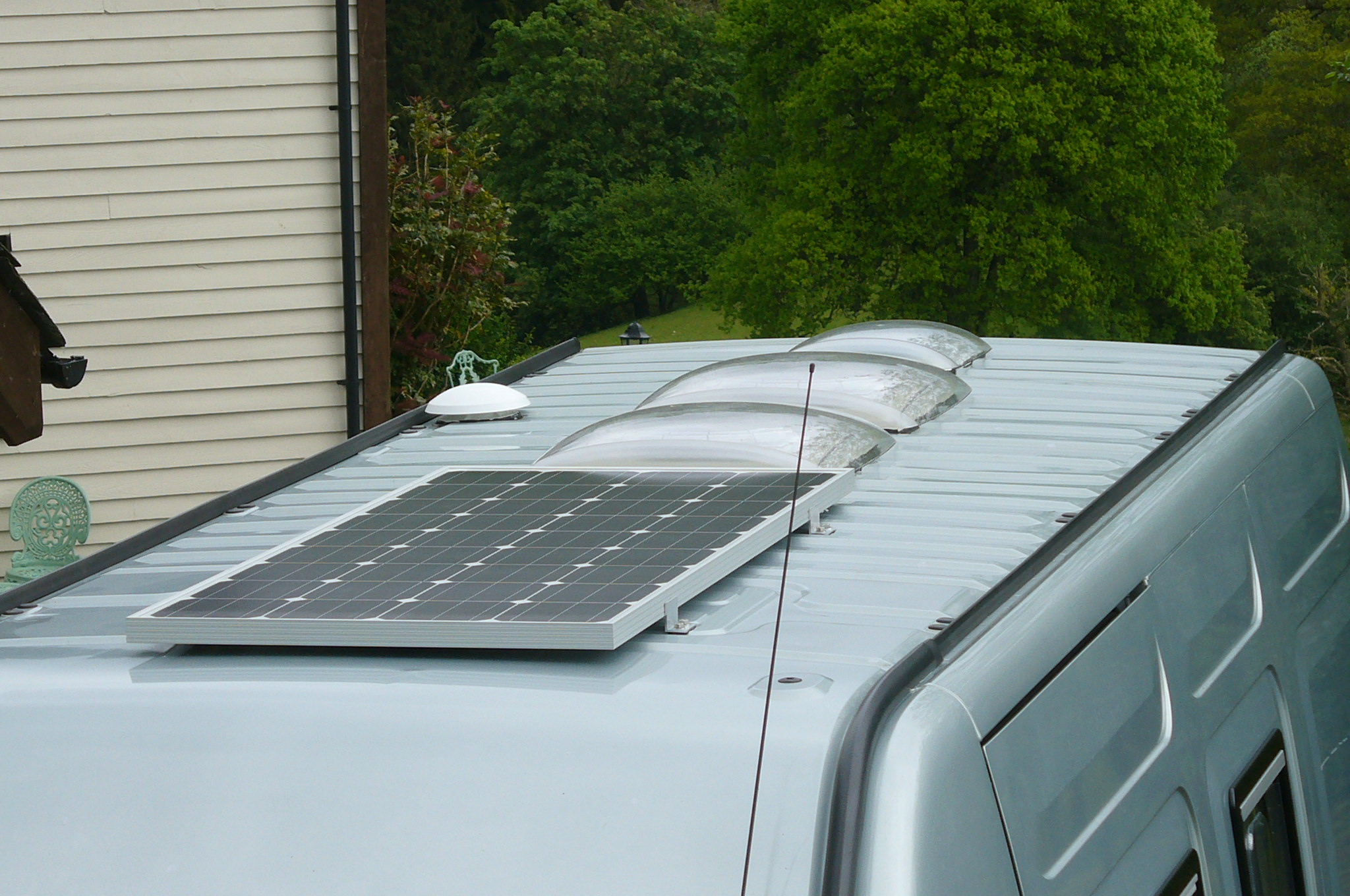

As others have written, as far as I am concerned roof lights are a must, I fitted 3 to the roof of 'Millie', my only regret was that I fitted MPK units as they cost significantly less than Heki but they do at lest let in light as well as giving the essential ventilation.

Roof lights can quite often result in quite a bit of extra wind noise which is why I installed mine directly behind each other with the solar panel directly in front the result is that 'Millie' suffers from very little wind noise.
The photograph taken in my original post was taken before I blocked off the gap at the leading edge of the solar panel.
