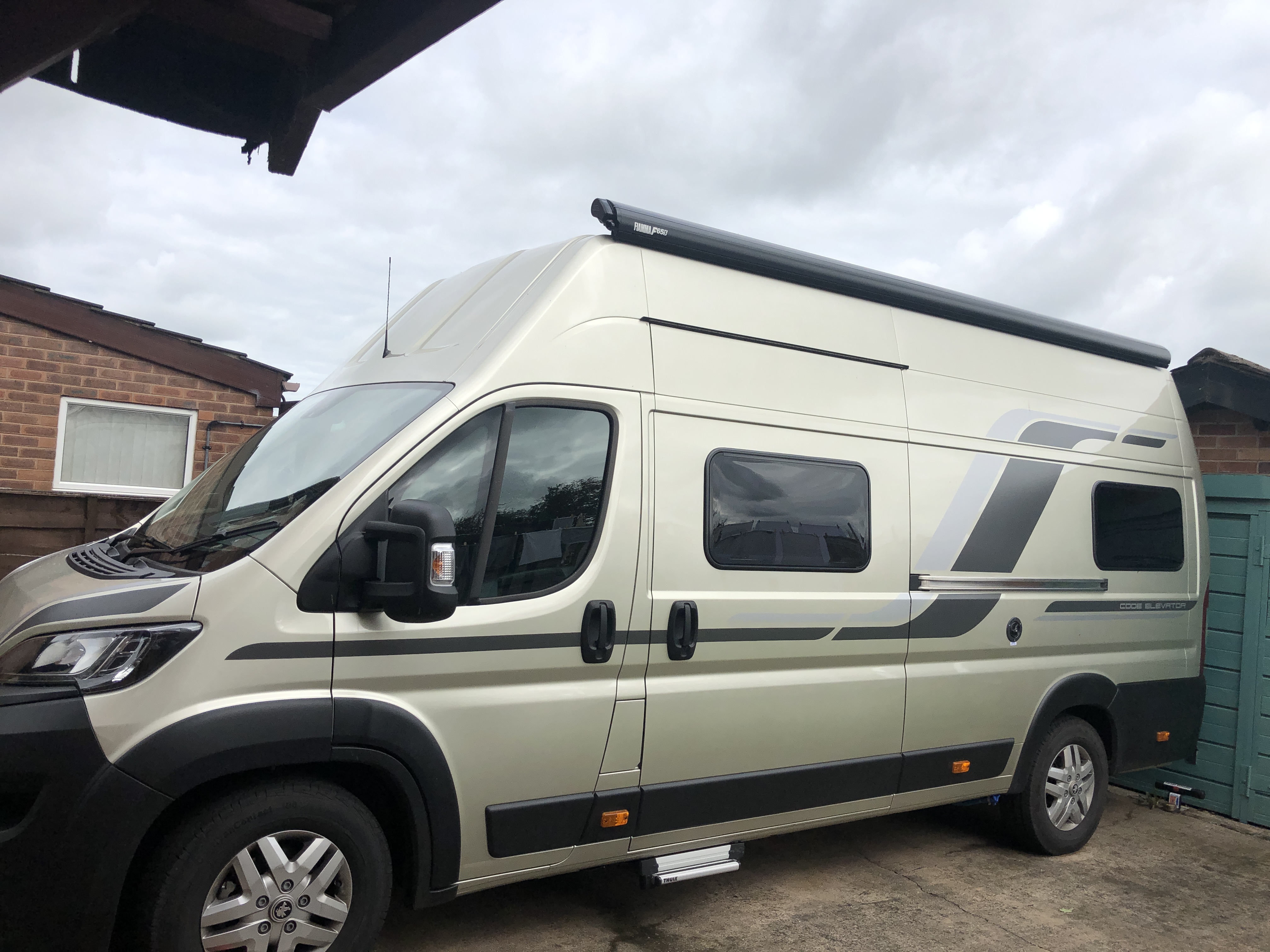

Think my pictures are above in this thread. Mine looks like a pro conversion from inside but outside didn’t have any stickers on it. I got a rejection letter same as yours . I had the local sign company copy (ish!) some graphics off a ‘pro’ converter and hey presto second try I have a ‘motor caravan’. I did make sure that all photos sent included shots with all the windows and roof vents open and included the toilet hatch , hookup etc. View attachment 1707
Im afraid your van is ANOTHER LEVEL of epic compared to ours (nice job on it btw). As ours is a lot smaller (we are students lol), Im not sure your tactics would work. That said, maybe its just a sign that we have to figure out how to earn more money to afford a 'real' van...
