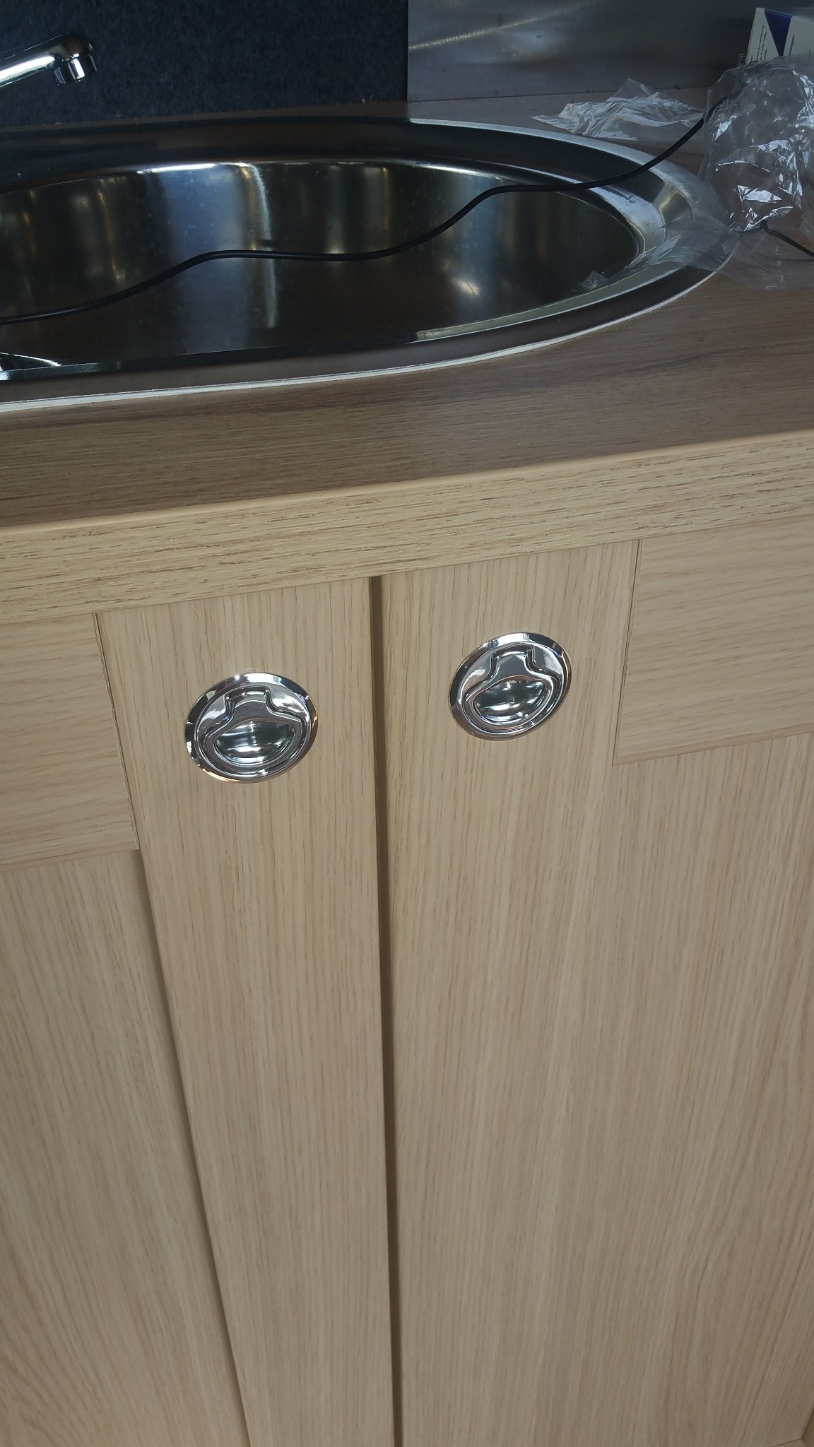

Finally made a decision. ... I've ordered "nautical" stainless steel slam latches the ones with a lifting ring to pull to open..

Decided on these marine slam latch ones.... the ebay advert was incorrect .. BUT I liked the look and the quality and to fit I had to grind a bit off the hook part of the catch and split the rear of the retainer into two parts.

#17
Thank you they were described as suitable for door thicknesses up to 38mm (they obviously confused that with the hole diameter of 38mm) my doors are 21mm thick and the unaltered hook only reaches18-19mm) so I needed to grind 2-3mm of the hook face. Split the back retainer into two, and use longer fixing screws to accommodate my thicker doors (x7 )

Nowt's straight forward is it, but it's made a neat job of it. :)
#19
Decided on these marine slam latch ones.... the ebay advert was incorrect .. BUT I liked the look and the quality and to fit I had to grind a bit off the hook part of the catch and split the rear of the retainer into two parts. View attachment 1464
A bit different from the ones normally seen and look very smart indeed :) great choice :D

Nick came round to visit me last week, very impressed with his van, diesel cooker/space heater, sink, calorifier, fridge and electrical installation, the cupboard catches are solid metal and not paint coated plastic if my cupboards were not curved I would replace mine with the type Nick has used, good effort Nick almost ready to reap your reward. 👍Phil
