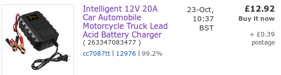

If you dont mind spending then numax chargers on the bay at £50 use a 5ah for engine and a 10 or 20ah for service batts.
#10
There are some ones from china on the bay which look like numax at much less dosh.
