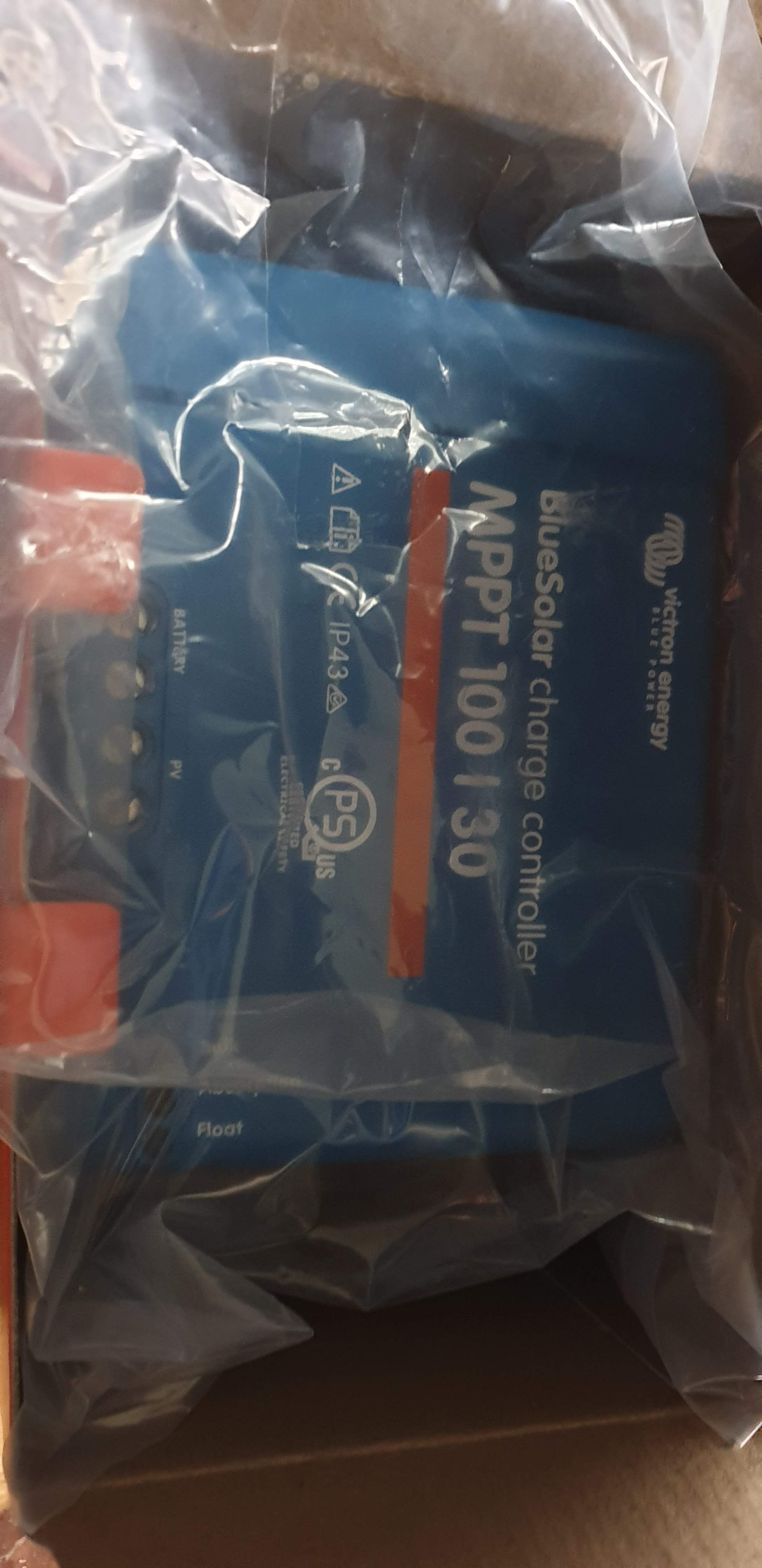

I got a good deal from Ian at Xerogrid for a Panel, 265W and a Victron MPPT 100 | 30
It's the next project
I am looking at Victron Manual and it says Mount on non flammable surface, large heatsink on the back. Has anyone mounted one of these anywhere. I am looking at doing it at rear of Van, a bit of a long run to battery at the front but will see what gives.
Anywhere in the Van to mount at rear is looking flammable at the moment !!
Has anyone used a Victron 100 | 30 and any idea how hot it might get with a single Solar 265W Panel, I would imagine not that hot as it's rated on nominal at 440W ??

Mine is in a wooden cupboard mounted to a wooden panel, before closing it up I monitored it for a while and it does not seem to even get warm. Rather than having long cable runs, if your worried about heat. You could mount it to an aluminium panel and then mount the panel where you like?
Mark

#20
I really don't think you need to worry about the heat generated by a 30A charger combusting a wooden surface :) All devices tend to have advice like that. Just think of the book "Fahrenheit 451" ... 451 degrees F. (232Cel.) being the temperature for paper to ignite.
As a correlation, after running a 30A B2B charger at full whack constantly for around 4 hours, the outer shell reached 50 Celcius. FWIW, I discussed the optimal mounting of the charger with the company and they said that ideally you would mount on a sheet of metal to help dissipate heat and fit that plate to the ply or whatever, but that really would be belt and braces (and at 50C max temp, I would agree as I had it in free air when it got to 50C)
The closest I have got to any high heat situation on my build is the heat from a ANL fuse holder scorching the ply when I was pulling around 250A for quite a while.
